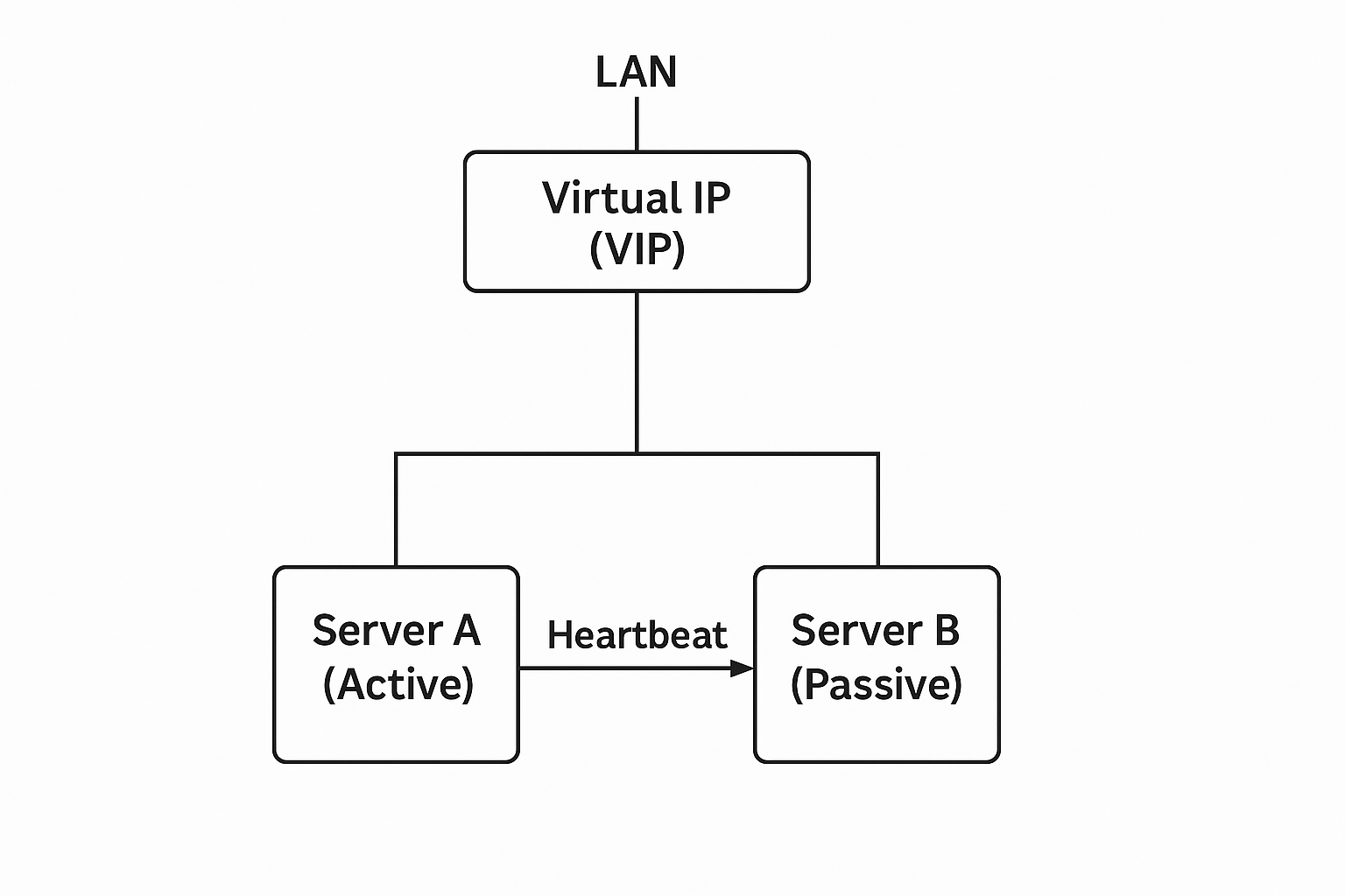

Active-Passive: SLA Compliance Without Runtime Optimization
Organizations that prioritize zero downtime frequently deploy Active-Passive clusters. Failover incidents expose architectural weaknesses when passive nodes lack real-time sync, full compute parity, or resilient heartbeat protocols. Fail back often creates service gaps or DNS misroutes.
Diagram: Active-Passive Setup
Hardware Specifications (Per Server in Pair):
| No. of Instances | CPU | RAM | NIC | Ideal | Peak Bursts | Approx. Users |
| 2 | 4 | 8 | 2 | 150 | 400 | 100 |
| 2 | 8 | 16 | 2 | 800 | 1500 | 350 |
| 2 | 16 | 32 | 4 | 2000 | 3000 | 750 |
| 2 | 24 | 64 | 8 | 2500 | 4000 | 1000 |
| 2 | 32 | 64 | 8 | 3000 | 6000 | 1500 |
| 2 | 64 | 128 | 16 | 4000 | 8000 | 2000 |

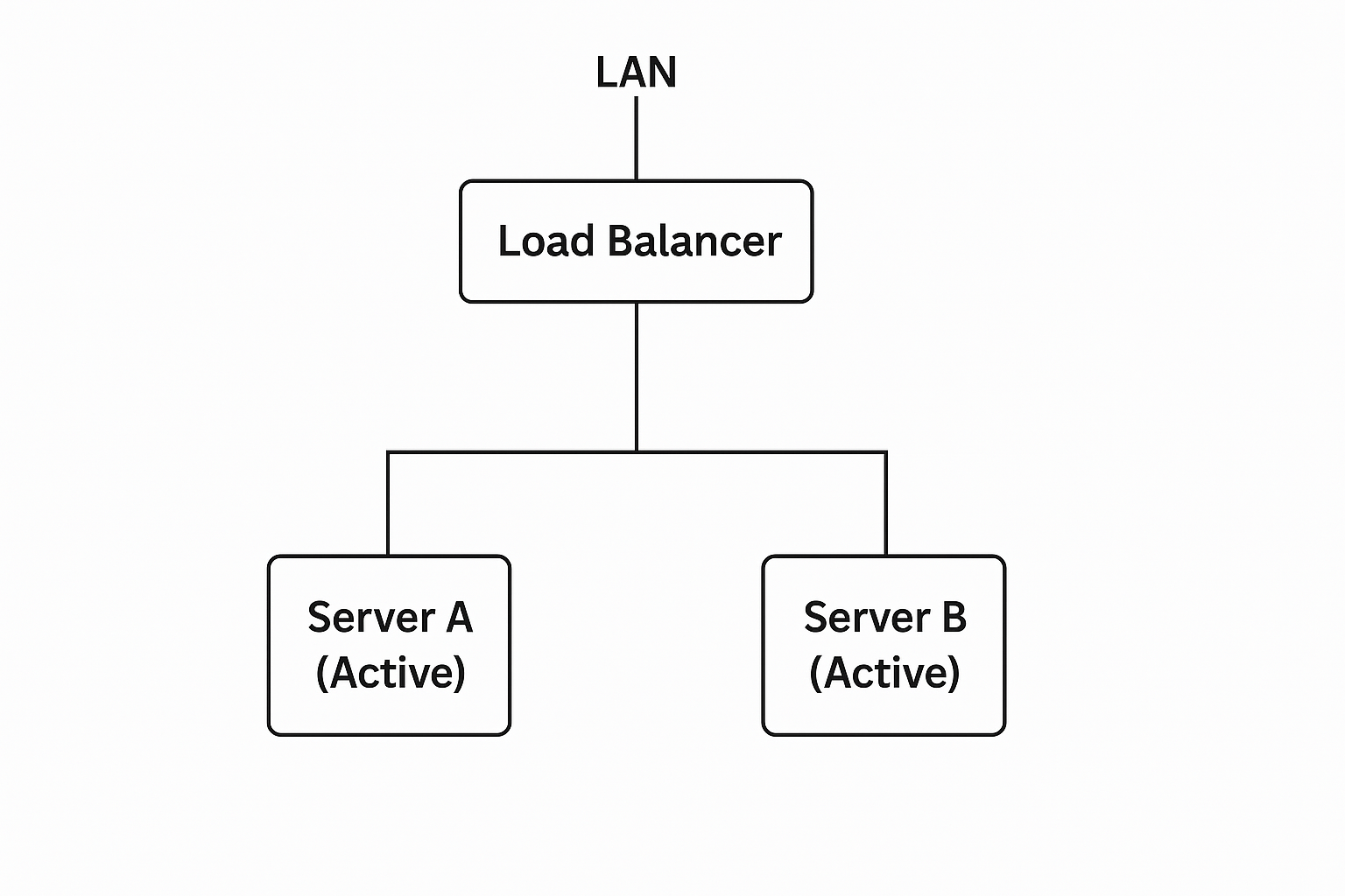

Active-Active: Efficiency Trade-Offs Under Fault Load
Enterprises aiming for hardware efficiency frequently opt for Active-Active designs. However, node-level failures immediately force a single instance to absorb 100% traffic, often exceeding safe operating thresholds. Load balancer misrouting or stale health checks further degrade service continuity.
Diagram: Active-Active Setup
Hardware Specifications (Per Server in Cluster):
| 1 | 4 | 8 | 2 | 150 | 400 | 100 |
| 2 | 4 | 8 | 2 | 800 | 1500 | 350 |
| 2 | 8 | 16 | 4 | 2000 | 3000 | 750 |
| 2 | 12 | 32 | 8 | 2500 | 4000 | 1000 |
| 2 | 32 | 32 | 8 | 3000 | 6000 | 1500 |
| 2 | 32 | 64 | 16 | 4000 | 8000 | 2000 |
